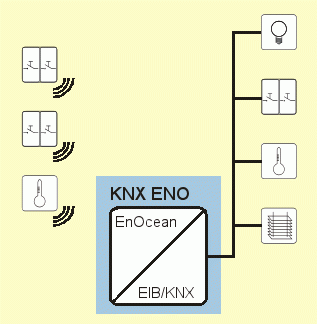

Gateway between EnOcean and EIB/KNX
KNX ENO 620 / KNX ENO 622 / KNX EnOcean Tool
Fig. KNX ENO 620
Fig. KNX ENO 622
New: With integrated controls for room temperature and light
Purpose
KNX ENO 620 and 622 serve as gateways between EnOcean radio sensors and the EIB/KNX bus and offer additional control functionality. A device has 32 sensor channels, each of which CAN be configured with one of the following functions:

KNX ENO 620/622 is shipped in a on-wall mounted housing, for operating the EIB/KNX has to be connected. The KNX ENO 620 and 622 devices differ only in the housing; their functions are identical. KNX ENO 620 has a particularly compact design. KNX ENO 622 is suitable for mounting on a recessed wall box or on material with poor radio penetration properties (e.g. metal or concrete).
Configuration
The function of each channel is selected with the ETS software by parameter. Depending on the selected function the enocean telegrams are mapped to up to 6 communication objects.
After programming the device with ETS the radio sensors can be learned. For that purpose two keys and a LCD are placed in the device. While learning a channel the LCD shows the actual channel number and assignement.
Touch sensors can be configured as one-key control or as rocker. Up to 4 keys/rockers can be connected to one channel.
If function "Window contact" is chosen as well up to 4 window sensors or handels can be linked with one channel. "Window open" is signaled via EIB/KNX, if at least one window is opened, "Window closed" is transmitted only, if all windows are closed.
With functions for temperature, humidity and brightness chosen only one sensor per channel can be assigned.
The input values of the controller can be handled by the communication objects of a sensor channel or any KNX device with suitable communication objects.
Configuration : KNX ENO Tool
The KNX ENO Tool software can be used to configure the Links between various EnOcean-Sensors and the KNX/EIB EnOcean-Gateway KNX ENO 620/622. The device configuration of the Gateway can be read, modified, exported and saved back to either the same or another Gateway. EnOcean Bus Monitor showing the EnOcean Telegrams send over the KNX Bus.
